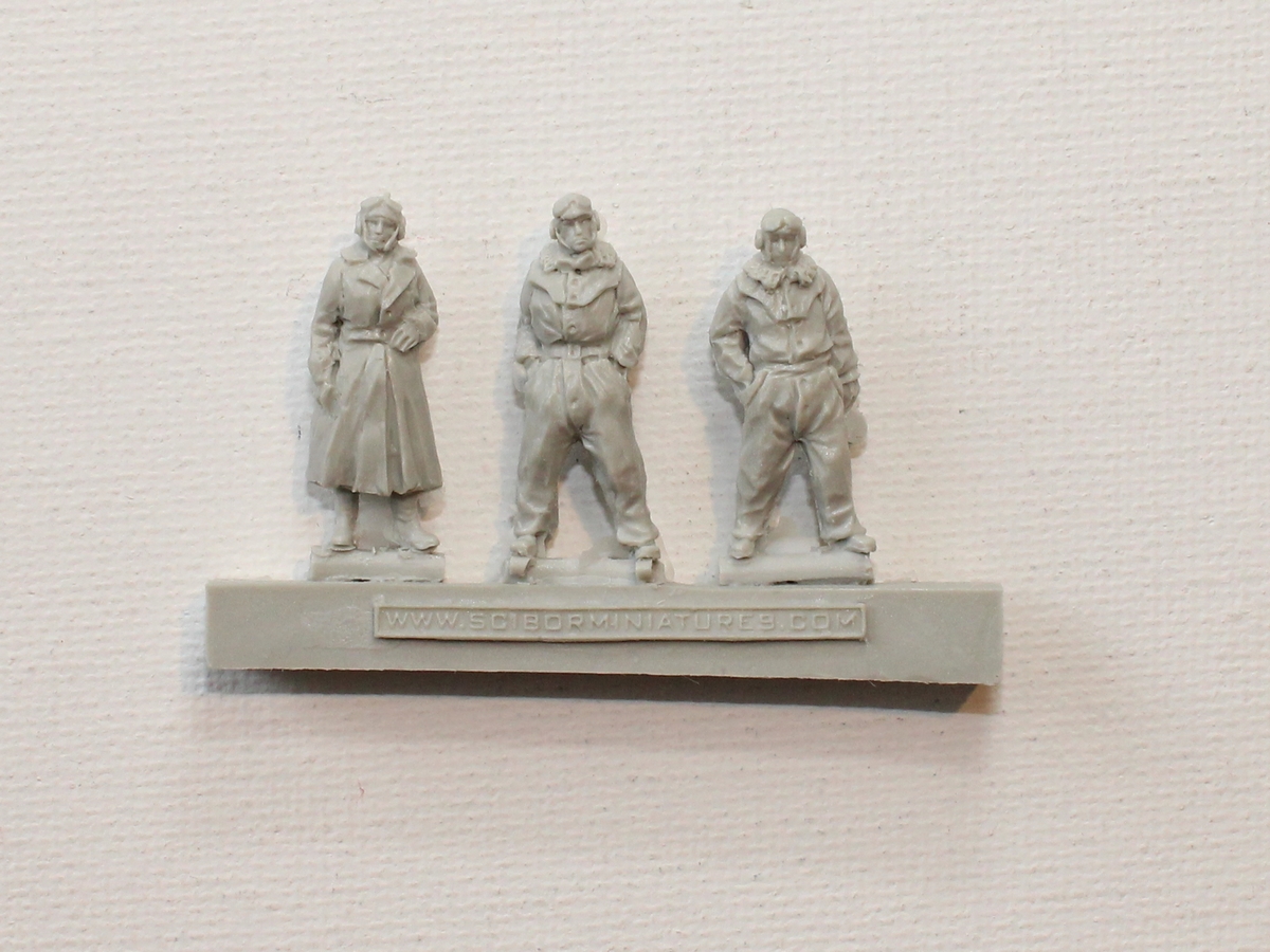

Pour aller avec, j'ai pris des figurines de chez Scibor Monstrous Miniatures
Ces messieurs sont fort sympathiques, mais ils mesurent 1,87 mètres. Un peu petit de nos jours certes, mais à l'époque c'était grand. Je prends quand-même celui du milieu avec ses mains dans ses poches et sa moustache chelou. Pas très ressemblant au vrai Jan Dzwonek dont je vais faire la décoration du "4 blanc de dinde" mais on fait ce qu'on peut aussi.
Noter la patine. Ignorer le pantalon façon Jacques Chirac la cravate façon Donald Trump.

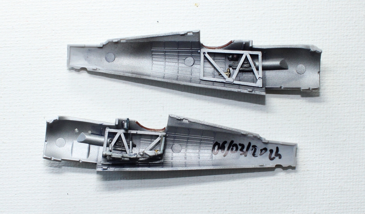

Pas grand-chose à dire, le plastique est agréable, le moulage globalement net même si quelques bavures sont à enlever. Une maquette plaisir :shock:
Le cockpit est bien suffisant. Juste le siège qui n'est pas ressemblant.
A blanc tout semble bien s'assembler. Là je vais coller tout ça pour vérifier!

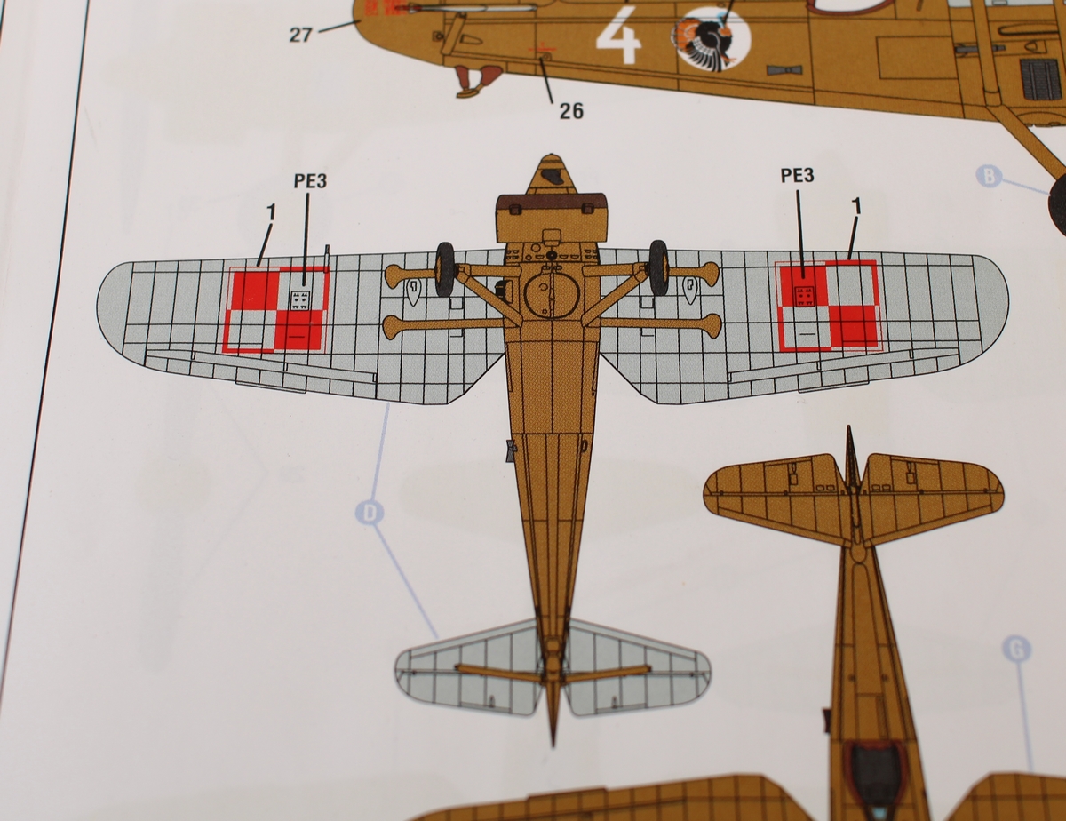

La planche propose les deux :
Comments from decal designers:
What were the colours of Ltn.Dzwonek’s turkey insignia? The answer to this question is, unfortunately, based on assumptions. When developing decals for the model, we had to face this problem. The popular image of the emblem (D) depicts many colours from the palette used in squadrons insignia. But it does not seem to match the shades of grey in the black and white photos. The picture also shows that the emblem was shaded on the body and in the area of ​​caruncles. The colours were apparently mixed, very probably to render the bird’s naturalistic appearance. Unlike in other squadrons, where the emblem was painted from the template.
During the development of decals for the model, we tested several colour variants. In the end, we chose two probable ones: A and B. We also had to adapt the emblem to the printing process of the decal. The silkscreen printing technique we use prevented shading. Also on such a small surface of the model, it would be practically invisible. For comparison, we present in the picture one of the colour variations of a turkey, occurring in nature
(reseach: Zbyszek Malicki, Grzegorz Mazurowski and Wojciech Bułhak, artwork by Zbyszek Malicki, turkey photo Adobe Stock autor: topshots )
rien que pour t'embêter, je choisis le marron :malin1:

Le cockpit s'assemble bien...
Le décal du tableau de bord est joli mais ne correspond pas à sa gravure. Ca passe!
Ca ne gêne pas la fermeture du fuselage. Mais lors du montage à blanc, je n'ai pas oser forcer pour l'enlever car les picots du plancher tenait bien dans la structure du fuselage. J'ai infiltré de la colle liquide.

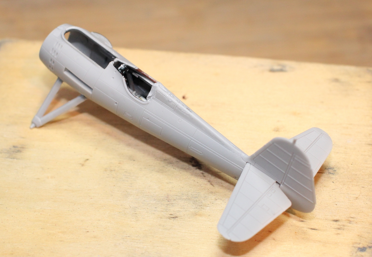

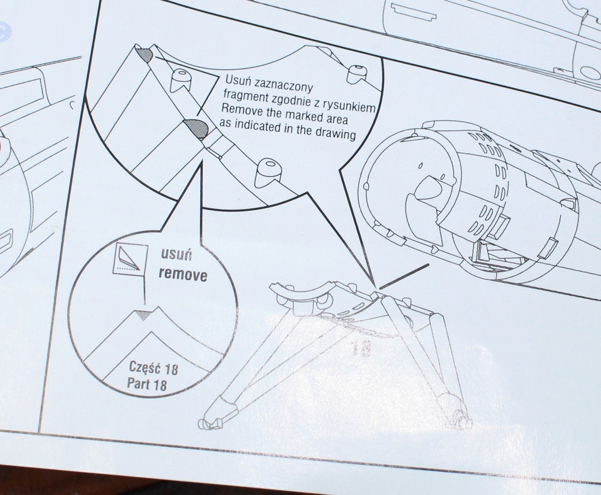

Par contre je n'ai pas trop compris ce qu'il fallait faire ici :
Echancrer le haut des jambes de train? La pièce rentre quand-même si on ne fait rien. Certes, il faut mastiquer.
Il n'empêche que cela avance vite
L'aile se présente bien, on peut la peindre à part :super:
La pièce du train était collée et je n'étais pas d'humeur correctrice, je n'ai pas modifié la position du radiateur signalée par Hadzi. Quand même, j'hésite entre "pffff", "d''oh!" et "cholera jasna" (pour rester poli).

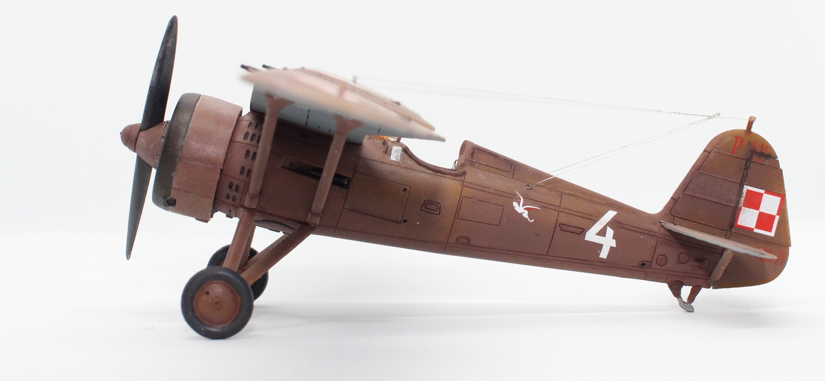

Re: PZL 11 Arma Hobby 1/72 09/03

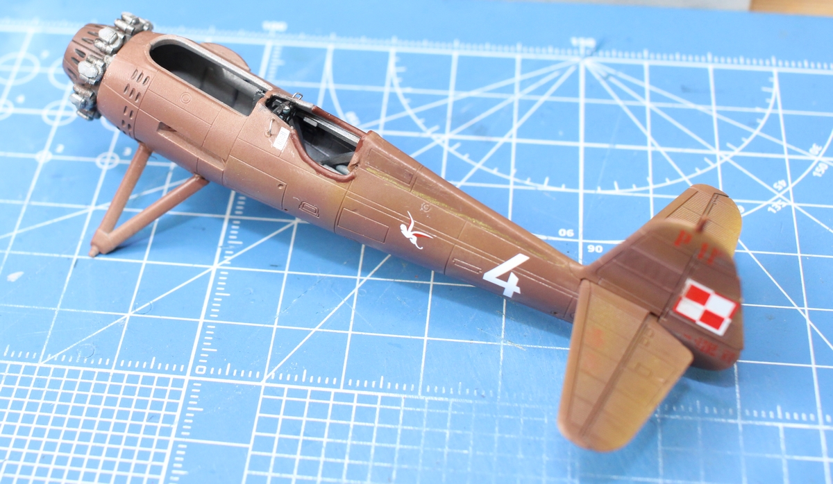

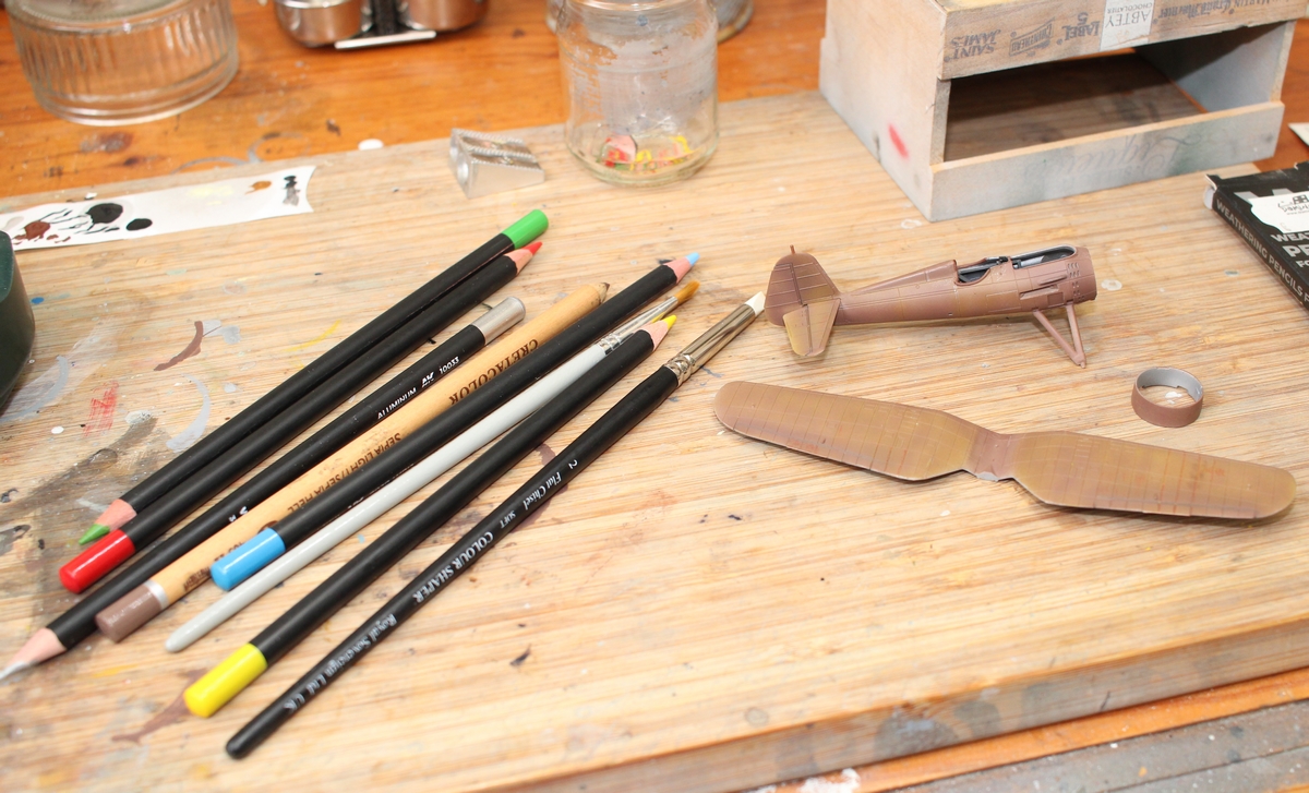

Peinture faite, avec un lavis à l'aérographe pour le marron pas vert. La gravure en damier étant faux, je me vois le peaufiner au crayon-aquarelle.
Messages : 30065
Re: PZL 11 Arma Hobby 1/72 11/03
Je suis fier du masquage de la verrière :frime1:
La première couche c'est de l'alu :
De la patine au crayon aquarellable avant de passer le vernis brillant :
Les décals Techmod sont un peu délicats à placer mais sans plus. La version KOP :
On inspire, on expire. Tisane "stress bio" (version sans CBD), FIP. Aérogrape Infinity, Gunze et diluant de la marque.
Dinde au marron pour Fabien L :langue2:

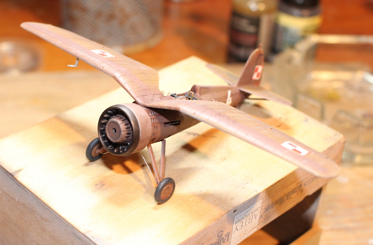

J'ai sorti la grosse artillerie pour les petites poignées!
C'est dommage qu'Arma Hobby ne les fournissent pas en photodécoupe alors que les viseurs le sont et que les trous d'accueil sont formés.

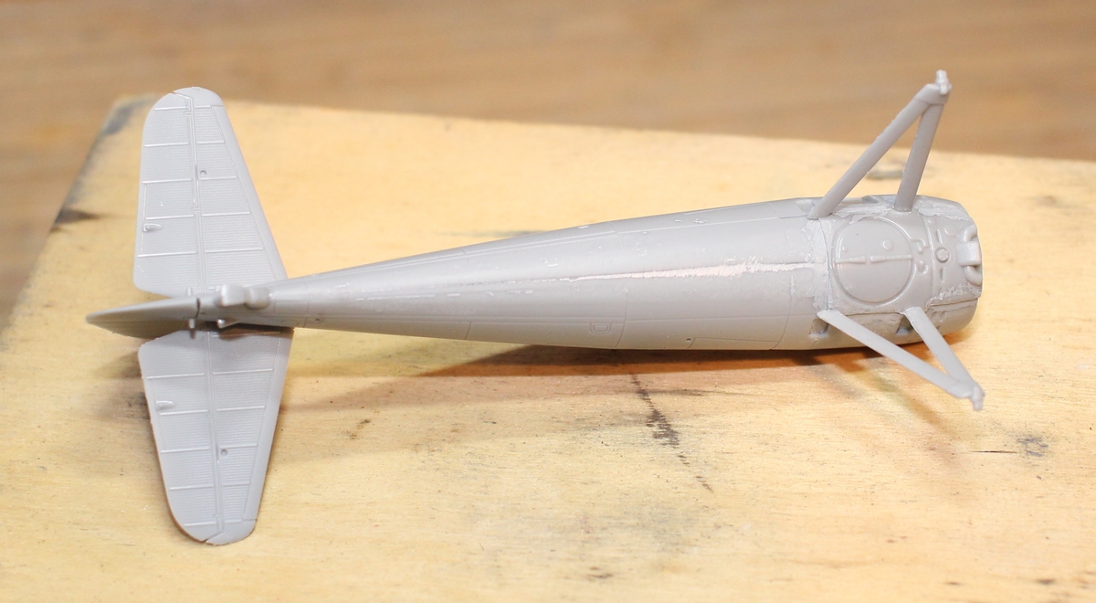

Le moteur s'enclique tellement bien qu'on ne peut pas l'enlever après un test à blanc.Heureusement, il part avec les essais du capot :malin1:
Un magazine de ma doc a instillé le doute en disant que les supports d'empennage n'étaient pas plats. J'ai cherché sur les photos d'époque : ce n'est pas évident mais les photos semblent montrer des pièces plates.

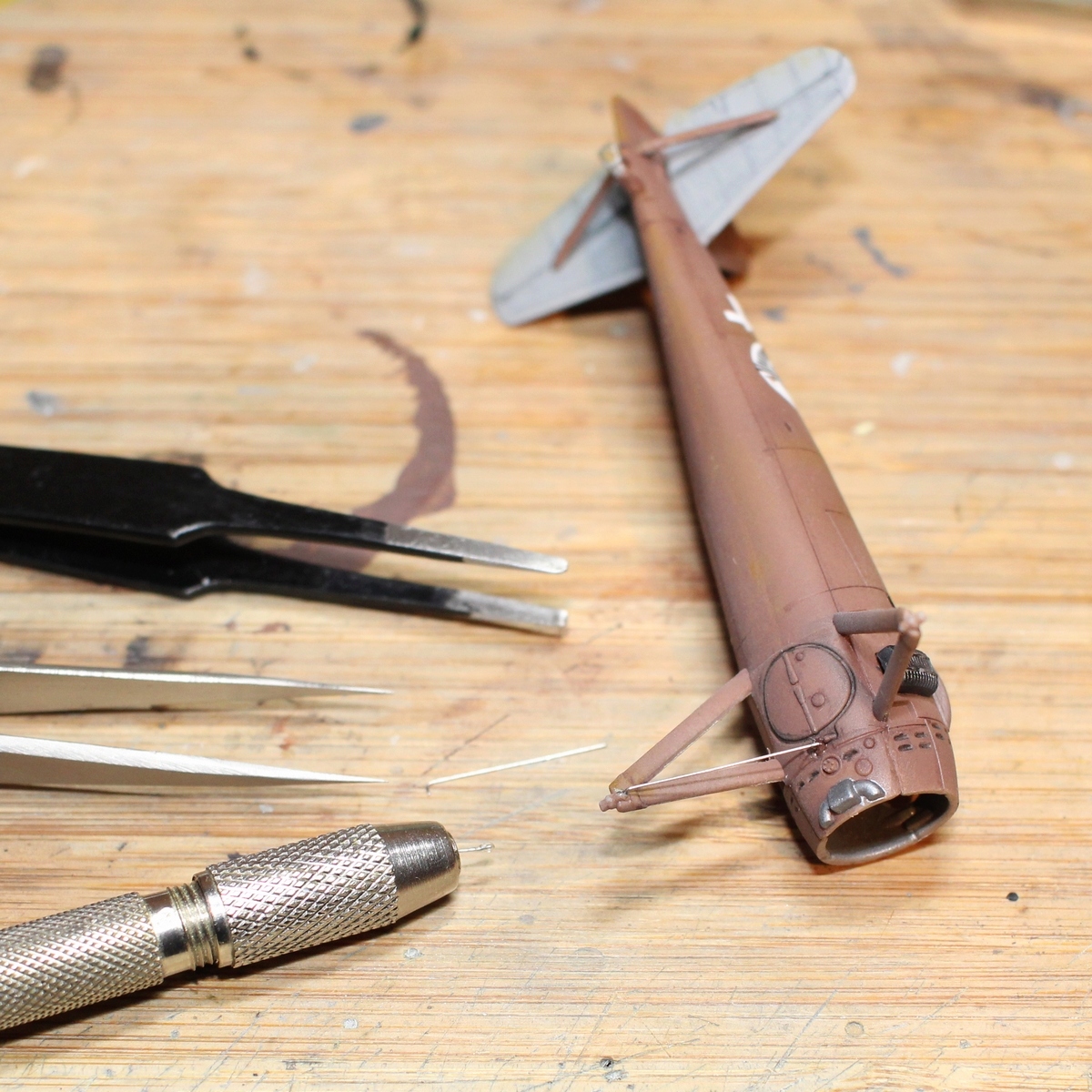

Après un peu de lavis et le vernis, le montage final a pu commencer. Il a été raccourci par la perte, trois fois, du brelâge... Mais je l'ai toujours retrouvé :frime1: Ca n'a pas nuit au calme nécessaire au collage de l'entrecroise du train :
Le moteur s'enlique bien sur le fuselage mais le capot ne s'enclique pas bien sur le moteur :pleur4:
Pas évident non plus le collage des armes de capot.
Il a du donc fallu poncer un peu le moteur. Ca passe... Le collage de l'aile se fait sans souci!
Encore quelques éléments à coller avant d'arriver au boss final : les fil d'antenne :shock:
Messages : 30065
Re: PZL 11 Arma Hobby 1/72 17/03
Un peu compliqué l'antenne mais je suis content de m'en être sorti sans trop de gros mots. Pas grand-chose d'autre à dire :alcool1: Bon, si : j'ai arraché la verrière, j'en ai récupéré une autre vite fait :rouge:
